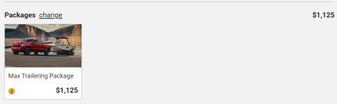

That package costs $1,125.
![1712854919566.png 1712854919566.png](https://forum.pickuptrucktalk.com/data/attachments/0/393-a89d3398c166cfc981ff47939e6b42e8.jpg)
It bumps your GVWR from 7,000 to 7,300.

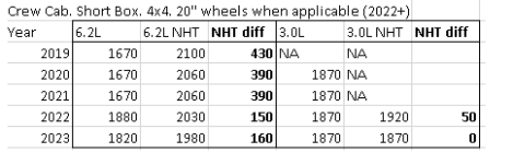

These add-ons also unfortunately add some weight to the truck, so that 300lbs of GVWR is not translated directly to your payload number. (shown in the chart below)
So, what was once a decent deal with a nice bump to payload has turned into a pricier option that nets less and less returns over the years.
This charts shows those diminishing returns with the 6.2 gas and 3.0 duramax on the base truck with zero options to maximize payload:
You can see in 2019 the payload had a good difference, from then on it's diminished from 430lbs difference to 160lbs on the 6.2. This is due to the standard payload increasing a bit and the NHT addon decreasing.
