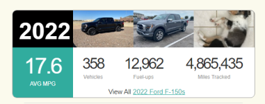

This is from Fuelly:
"Based on data from 226 vehicles, 3,751 fuel-ups and 1,382,938 miles of driving, the 2023 Ford F-150 gets a combined Avg MPG of 17.46 with a 0.12 MPG margin of error."

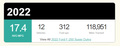

Also from Fuelly on the 2022 F250 Powerstroke:
The spread on GM seems larger from 1/2ton to 3/4 ton but it's hard to parce out the engines. I know the F250 is outperforming the Silverado 2500 in MPG.

The downside is some people set up their profile with their exact specs engine etc.,
others just enter their info as a default F-150 so you have to be a little careful at what you're looking at.

Unfortunately, they don't really get many data points, like the F250 numbers were only from a total of 12 trucks. Some times you see some years increase by 2 then drop back down where they were.
